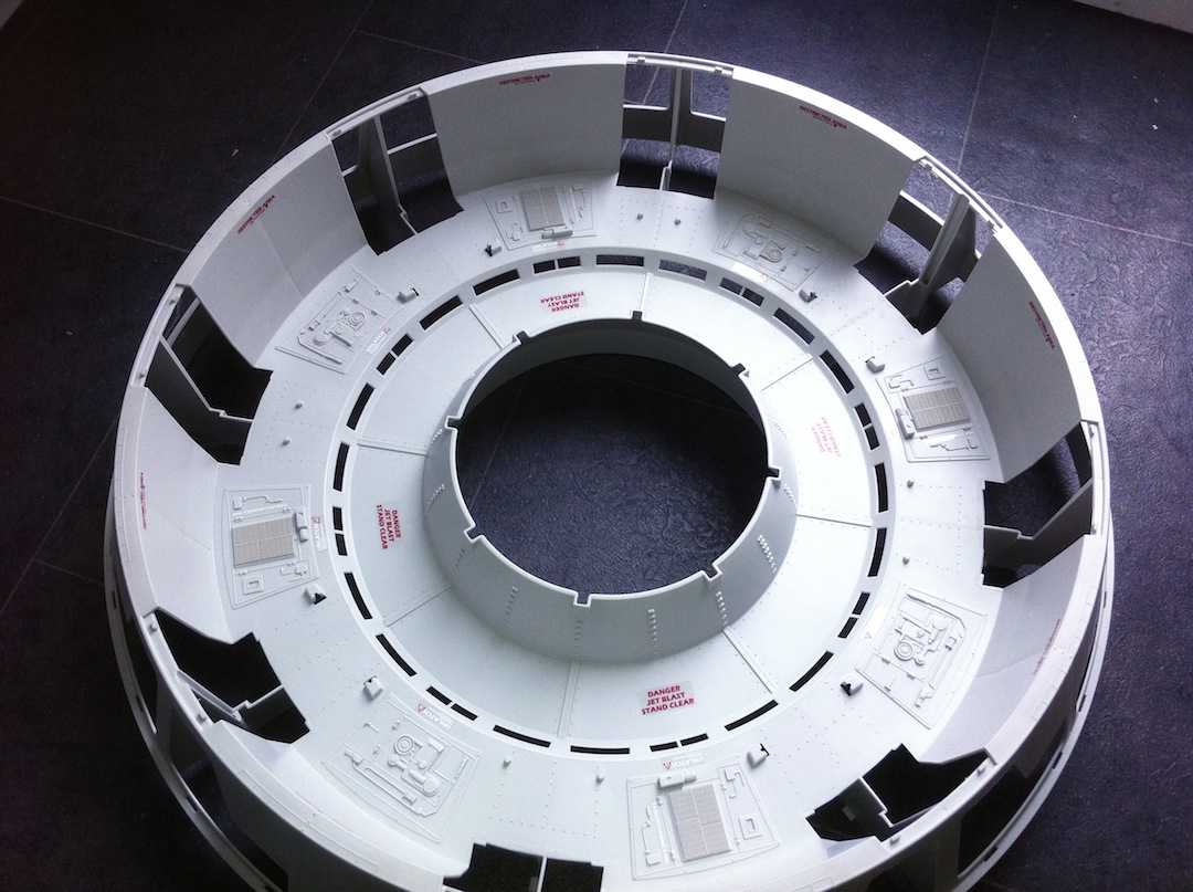

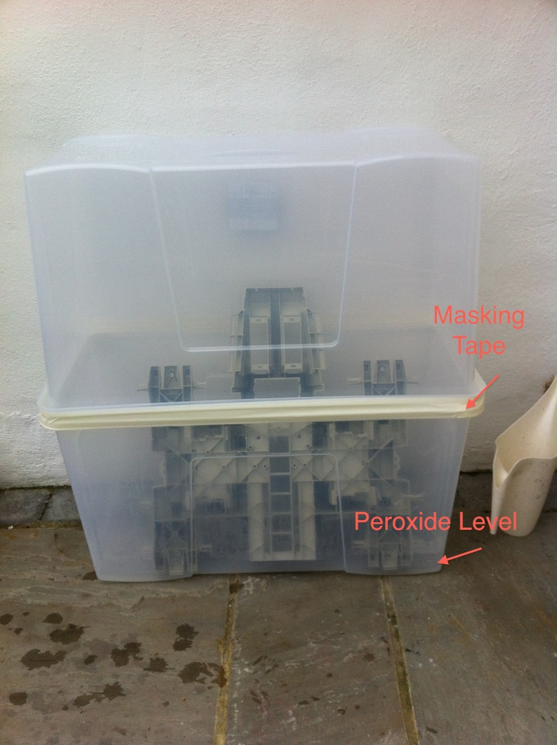

Thanks for being patient, so here's my guide to the use of peroxide!
WORD OF WARNING, PEROXIDE IS A NASTY CHEMICAL, USE SAFETY PRECAUTIONS SUCH AS GLOVES, GOGGLES AND HOSE EVERYTHING DOWN AFTER. KEEP PETS AND CHILDREN AWAY.
What you'll need:
-35% Tech grade Peroxide 1ltr is sufficent for a Defiant so there's no need to get more.
-Rubber Gloves & Goggles
-Masking Tape
-Clear container, IKEA do a great range that are "Lipless" so the tape can go on smoothly.
-A Garden Hose
Step 1: Prepare the toy by cleaning it off with warm water.
Step 2: Place toy in the bottom of the container and carefully pour the Peroxide in, If you get any on your skin wash under cool water, It can sting and turn fingers white but after half hour you should be ok
Step 3: Place lid on and tape round the edges so no vapour can escape, then leave for 48hrs for the magic to happen. The sun will help but i've whitened stuff in darkness with great success
Step 4: After about 48hrs remove tape using gloved hands and without breathing in lift lid (In all honesty I've breathed shed loads in and I've not had issues) remove the toy and thorougly wash with garden hose.
Ta-Dah! all done.
Over the last year i've done pretty much all my yellowed toys, the best and longest lasting results are from coloured plastics. My TD has had about a 10-20% return but the cause may be because my colection is in the attic. I wouldn't recommend the process more than twice, I've wrecked a Payload figure after 3 attempts. Hope that helps.
