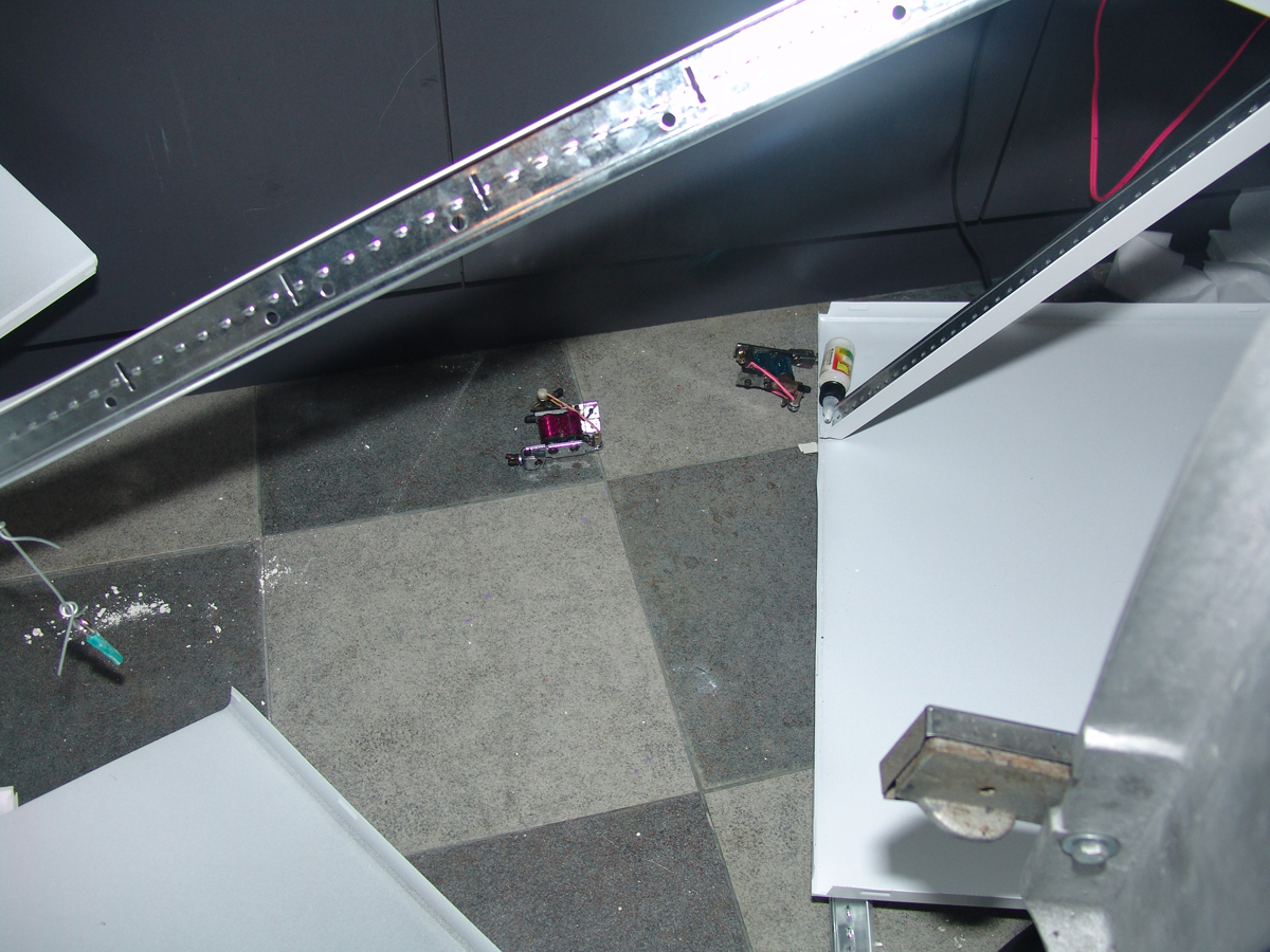

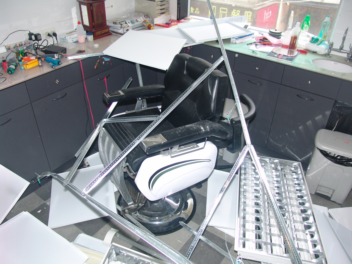

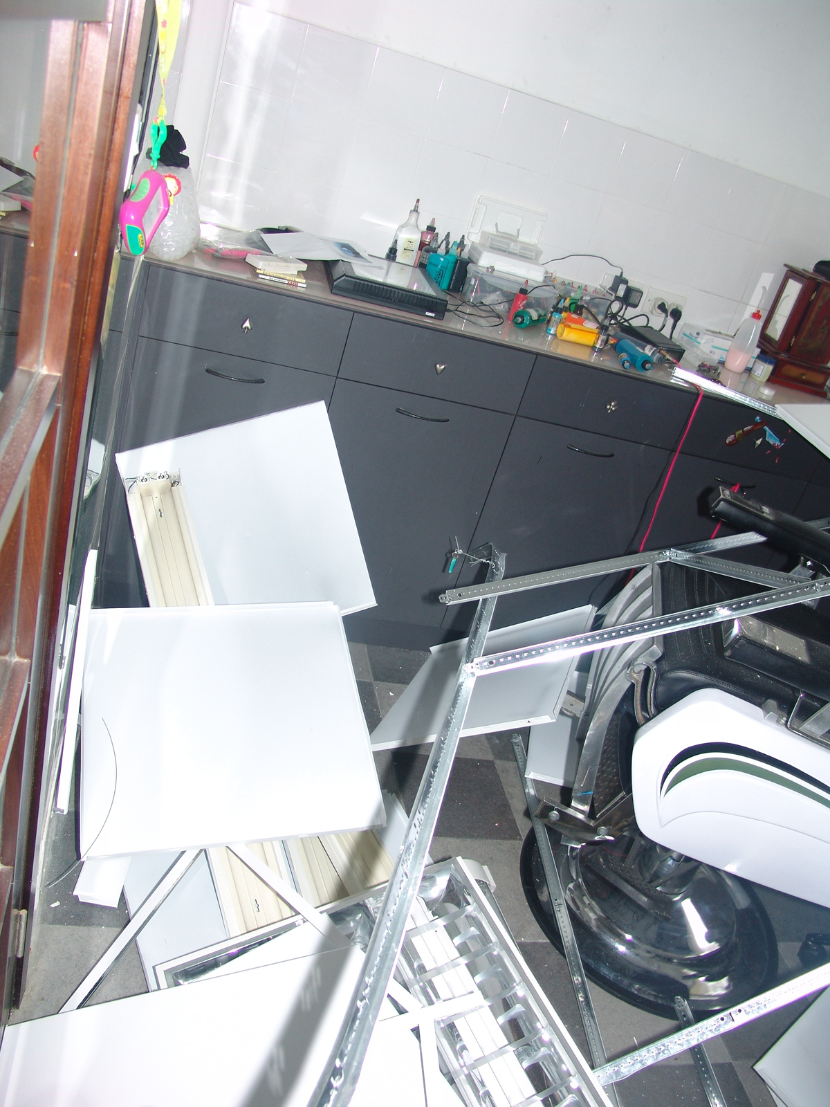

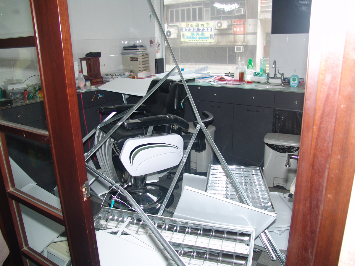

heres a pics of the damage:
julias 2 favorite machines.....

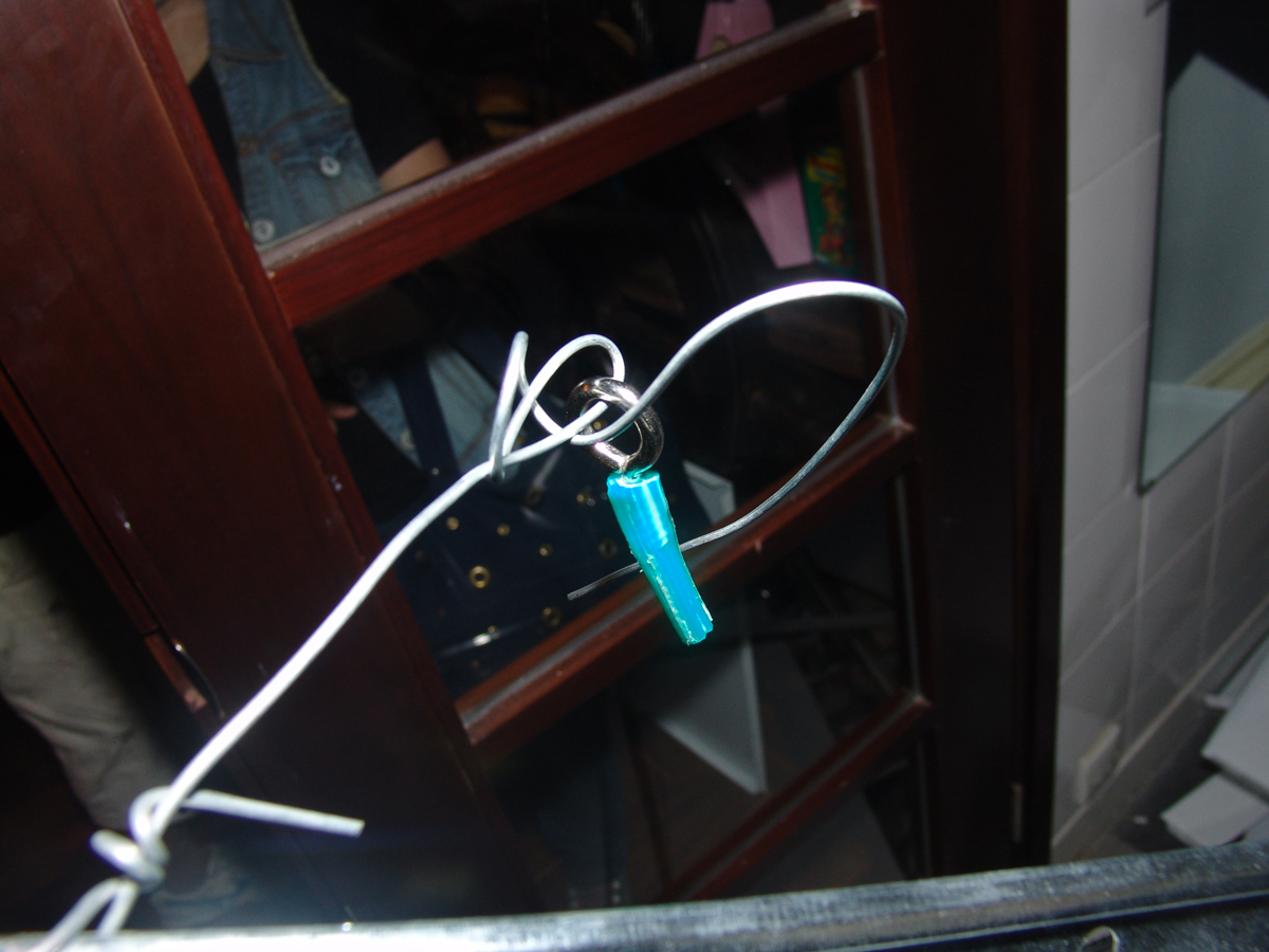

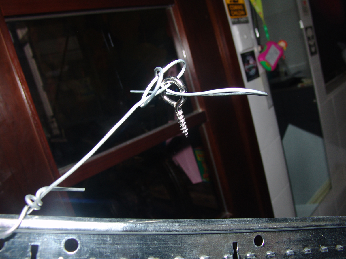

the half inch long screws that were supporting everything....

Jeez :shock: ..I'm no expert, but that looks like well dodgy workmanship..thank god nobody was in the room when it came down!
Was that the only room that had had a new ceiling put in?, if not I wouldn't dare use any other rooms that have been done by the same cowboys..

absolute f*cking cowboys, half inch f*cking screws! turns out the light fittings were too heavy for the beams used & there werent enough support wires. the representative from the company that did the work kept laughing @ me when i was trying to explain that air pressure from opening doors cant cause a ceiling to cave in so i had to use very simple english (he doesnt really speak any) to explain that i was going to take a piece of metal debris & ram it through his throat if he didnt stop laughing. he stopped..............
